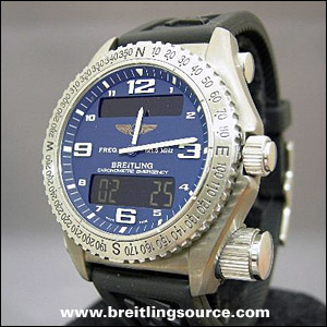

Professional Series - Emergency Superquartz
The Breitling Emergency was originally design for pilots and aircrews. It is a watch with a built-in micro-transmitter broadcasting on the 121.5 MHz aircraft emergency frequency and is designed to complement the distress signalling equipment of any aircraft. Following a crash the 'Emergency' will broadcast a signal on which rescuers can home in.
The transmitter is activated (for 48 hours) by unscrewing a protective cap and pulling the antenna out fully. Over flat terrain or calm seas, the transmitter signal has a range of about 160Km (assuming the search aircraft is flying at an altitude of 6000m).
NOTE: Battery Changes on the Breitling Emergency Watches should be performed by authorized AD as the battery change is quite complicated.
| Model: | Emergency Superquartz |
| Production Years: | 2002-2012 |
| Case Materials Available: | Titanium, 18k |
| Movement: | Breitling 76 |
| Battery/Battery Life: | 399/3-4 Years |
| Water Resistance: | 30m |
| Bezel: | Bidirectional |
| Crown: | Push-Down |
| Diameter: | 43mm |
| Thickness: | 15.7mm |
| Weight: | 84.6g |
| Bracelet: | Professional Titanium II |
| Lug Width: | 22mm |
| Reference Numbers: | E76321, J76321, E76021 |
